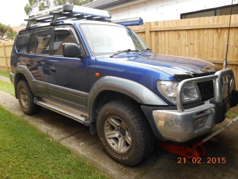

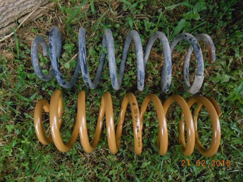

Postby Taziiy » Sat Feb 28, 2015 8:19 am
Well I had some time to spare so I thought I would put the suspension in :dance: that soon turned to :001_9898: the front wasn't to bad as they where pre assembled but the rear was a whole other thing.
Setup up get started and then it starts to rain nothing to worry about you say, it does when you are working in your driveway as you have nowhere else. :mad:
ok some before shots
the difference between the originals and the new ones
Then we got to the rear besides toyota making a huge mistake in very minimal access under the vehicle and no access through the body it was real hard to get to the top of the shocks but after finally getting a spanner in there you turn the shock to get them out only to have the thread snap due to wear and tear on the old shocks
A shot of the rear springs
Anyways after what I though would be a one day job took me 2 and then as I un done the front control arms and rear trailing arms not to twist bushes I then managed to completely stuff the front wheel alignment so I manage to adjust it the best I could by eye to get it drivable for a trip to the wheel aligners on the monday (which didnt make the MRS happy as it was her daily drive luckily I have a really understanding boss as i gave my company car to the mrs and the boss picked me up from the wheelaligners and gave me his car to use for the day). Anyways here is the finished result before it went to the wheel alingers.

Postby beaujest4 » Sat Feb 28, 2015 11:50 am
Just a bit of lift gained there. Done well Taz

Postby Taziiy » Sun Mar 01, 2015 5:11 pm
Yep just a little the front should come down some wore once the steel bull bar and winch gets on there
